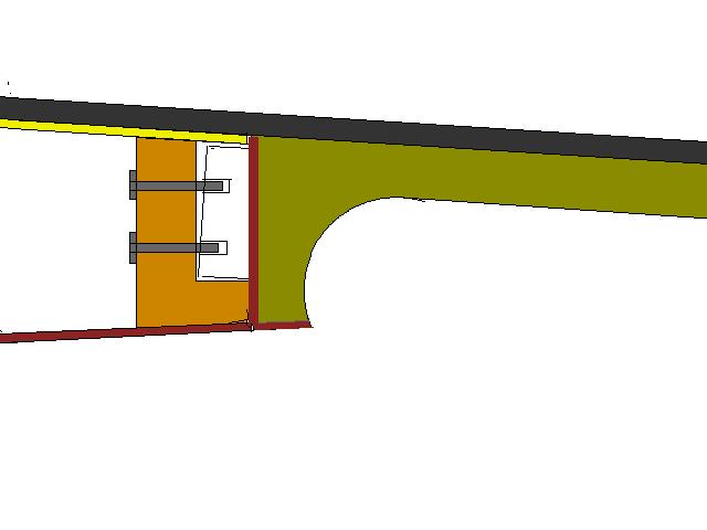

This is how my neck join turns out. I use screw-in inserts to attach the neck. The screwe insert are drilled perpendicular to the side of the guitar. The tenon on the neck a bit shorter than the mortice so I don't bother to make the end of the tenon parallel to the mortice. The bolt holes in the head block are slightly oversize so that I can fine tune the fit when I set the neck. I get a degree of freedom that way. The whole thing is stable because the cheeks of the heel are pressed tightly agains the side of the body. If the bolts loosen, then the neck could slide around a bit, but the bolts don't loosen and, when the fretboard is glued to the top, there is even less tendency to move around.
The top and bottom of the head block are angled to reflect the dome of the top and back. The angle here is different for the top and bottom because the dome is different.
I make the neck completely seperately from the body and only attach them after the finish is on. That includes fretting. To keep the fretboard extension from bending, I bolt on a block of wood to the neck to support the extension. This allows me to level and dress the frets while not attached to the body.
The angles in the illustration are exagerated.

Mike, your drawing helped very much as long with your explanations
